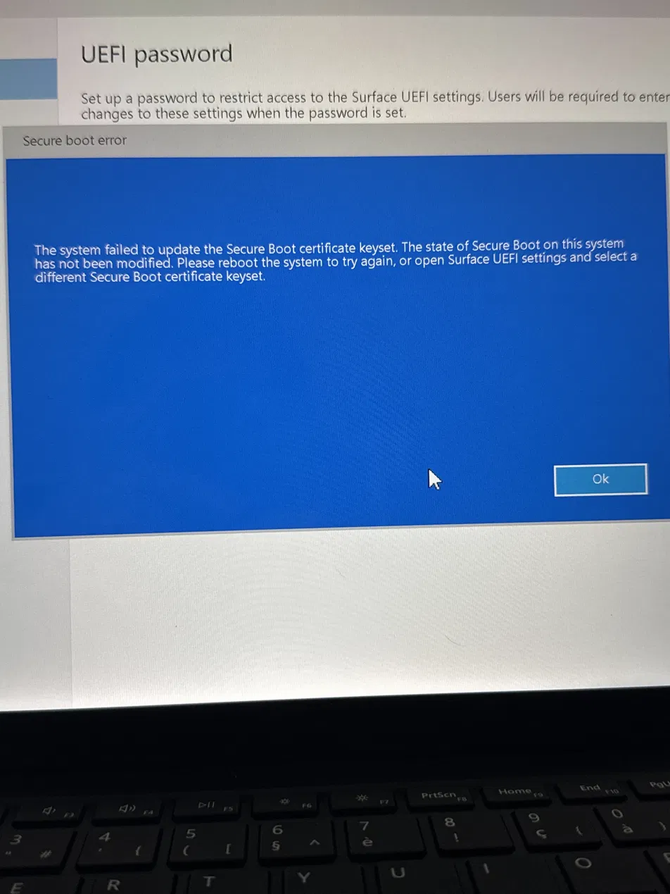

Secure Boot cannot be enabled on this Surface Laptop 5. Error: "The system failed to update the Secure Boot certificate keyset" (both Microsoft Only and 3rd Party options fail).

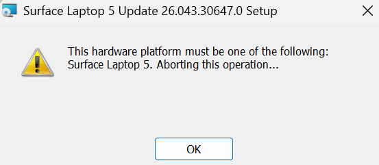

  6. Tried official Surface Laptop 5 firmware MSI from microsoft.com/download/details.aspx?id=104679 - installer fails with "This hardware platform must be one of the following: Surface Laptop 5. Aborting this operation."

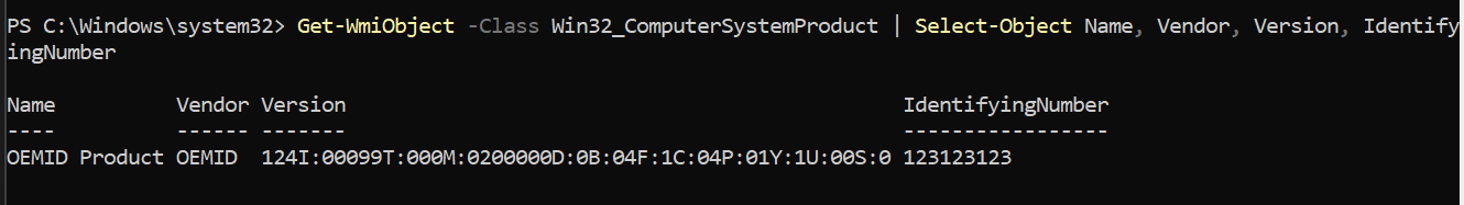

  7. Found root cause for #6: Win32_ComputerSystemProduct shows Name="OEMID Product", garbled Version string, and IdentifyingNumber=123123123 (incorrect serial), instead of correct Surface Laptop 5 / serial 0F0016923213FB.

    Thanks for your detailed diagnostics and clear visual examples. It seems like your system no longer identifies itself as a valid Surface Laptop 5, which breaks firmware validation checks. If none of the software fixes work anymore, you suspicion on a firmware-level issue might be correct.
