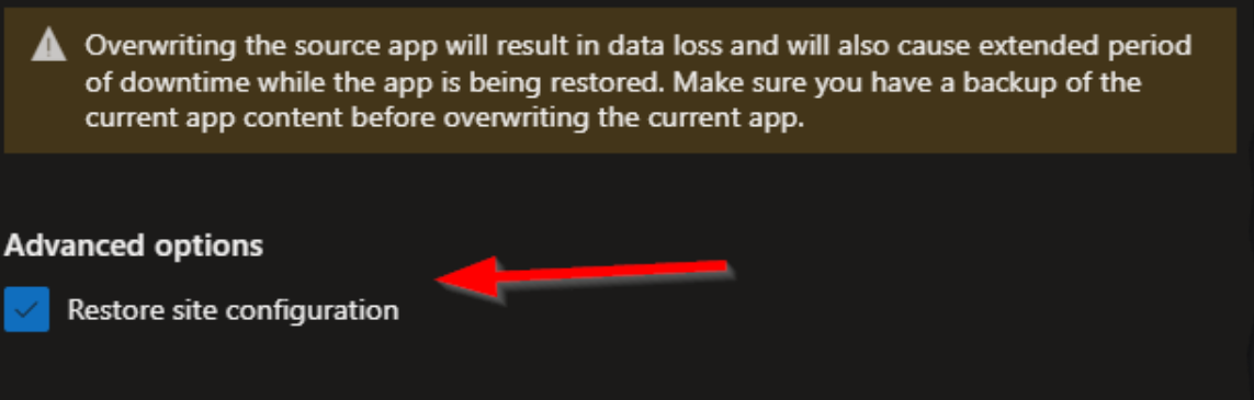

  • Multiple attempts were made to restore the App Service from a backup (including site configuration).
  • The restore process did not resolve the issue.

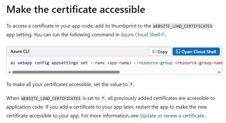

  • Eventually, it was discovered that a certificate could not be loaded due to a mismatch in the value of an environment variable (WEBSITE_LOAD_CERTIFICATES).
  • The mismatch was a single-character difference in the certificate thumbprint.

  • Backup restore did not appear to revert the misconfigured environment variable.

  • Should Azure App Service backup/restore include environment variables like WEBSITE_LOAD_CERTIFICATES?
    • Under what circumstances would these settings not be restored?
  • Certificate handling
    • Is using certificate thumbprints in app settings considered a best practice, or are there more robust alternatives (e.g., Key Vault integration)?

    Your outage was caused by a bad IaC-supplied WEBSITE_LOAD_CERTIFICATES thumbprint. The manual correction fixed production, but the durable fix is to correct the IaC source, stop manually typing thumbprints, add a pipeline gate that verifies the configured thumbprint against the actual App Service certificate, deploy first to a staging slot, run a certificate/authentication smoke test, and only then swap to production. Do not depend on App Service backup restore as the primary rollback for this class of issue, and make sure you use slots and deterministic IaC rollback, and use restore only through a tested slot-based recovery runbook.
