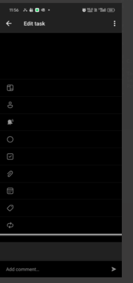

We are experiencing an issue when performing operations using Microsoft Graph API, where these operations appear to be breaking the UI.
The issue consistently occurs when using a Service Principal (app-only authentication / client credentials flow). All required permissions are granted, and the API operations themselves execute successfully without any errors.

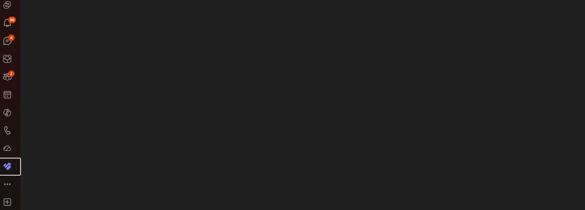

User's image However, after performing operations via Graph API, the UI in both Microsoft Teams (Planner) and the Android Planner app fails to load data correctly or becomes unstable.
User's imageUser's image

Observed Behavior
  • API calls (create/update/delete) succeed with valid responses
  • Tasks are correctly created, updated, or deleted via API
  • However, immediately after these operations:
    • Teams Planner UI fails to render properly
      • Android Planner app is unable to load tasks
      • Interestingly, if we manually update the same task via UI (e.g., change status), the UI starts working correctly again
  • But performing another operation via API causes the same issue to reoccur
